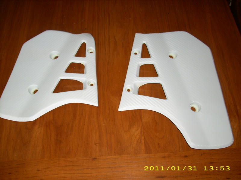

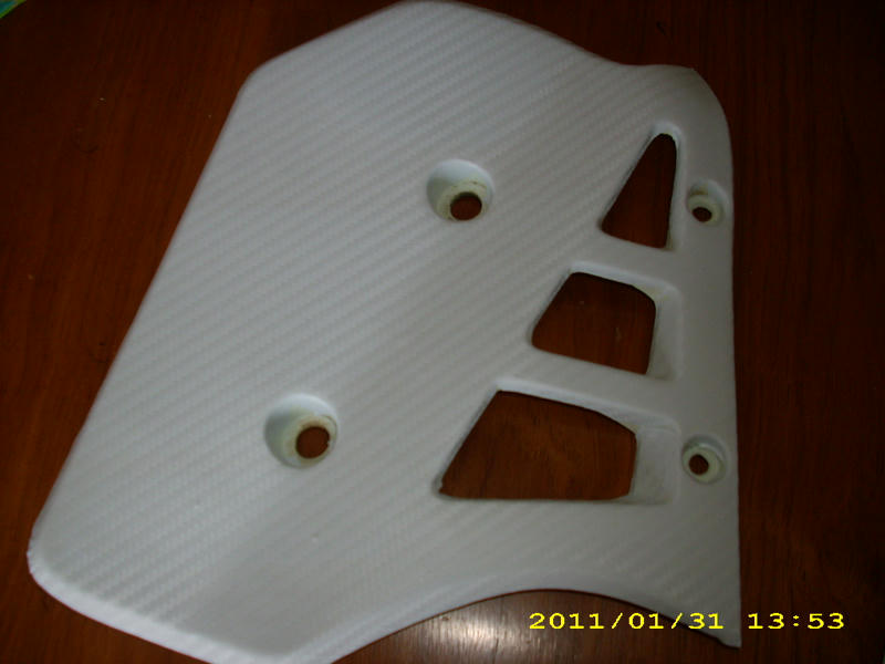

after removing the stickers from the bike... I realised how tatty my plastics were even after using the heat gun and novus polishes
So I got busy with the carbon wrap
Pics are in the techincal section of forum in my build thread
