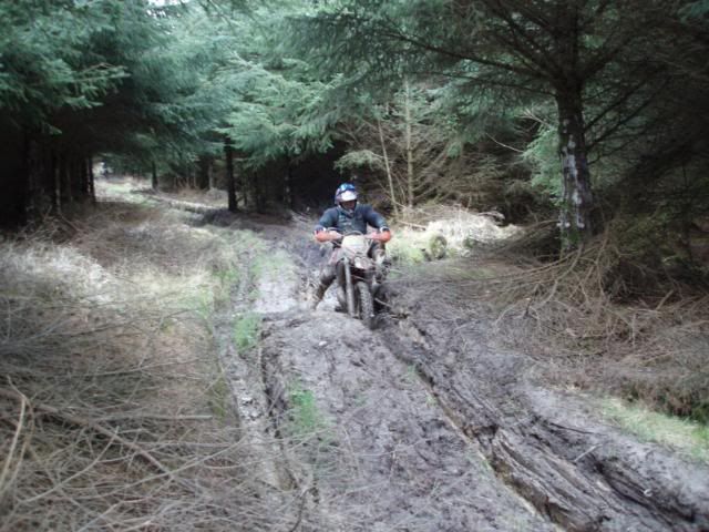

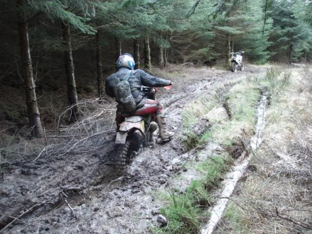

Here are a couple of photos to set the scene. The bike had been working hard before it was stopped.
The first shows a bike climbing out of the deep water.
The second shows my bike parked against a tree.

Eddie , do you run a fan on your rad at all?
Cold shock seizure?, it's looking the most obvious culprit.
