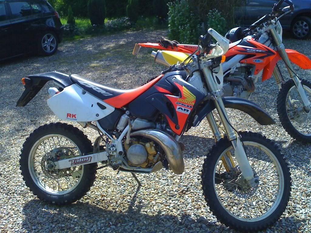

P.S can i put a picture of the winner up on here?

See if this works.....
