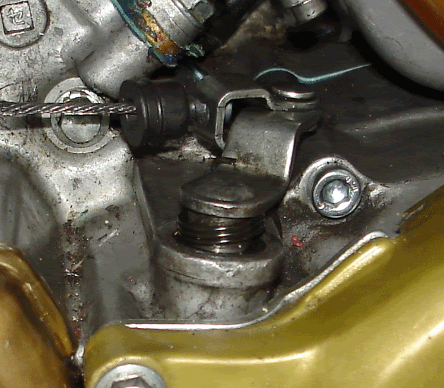

Is this petruding too far out?

How much free play is there on the end of actuating arm in casing[ where cable attaches].there should be a few degrees of movement.
Sorry mate ,your going to have to take casing of again to check clutch reassembly.
Re: Clutch Problem?
I don't think there is any free play in the arm- fitting the clutch cable was pretty diffificult
and a hell of a stretch to the acutator arm, If it does turn out to be the acutator arm, what do you think
needs rectifying? does the push rod only install one way round? I can't think what to do differently
when I strip it again tommorrow.
