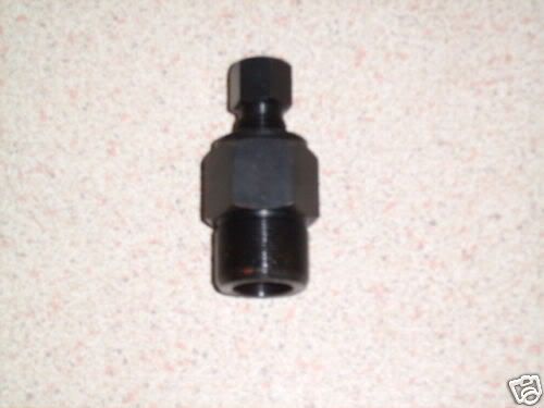

any chance of a piccy of the puller I need? its a lot easier to find something here if I can wave a piccy at them...
would like to get one asap!

Re: question about measuring alternator/ stator resistance
like this?
http://www.amazon.com/Flywheel-Puller-2 ... B005CWA1I2
or is this one better?
http://www.ebay.co.uk/itm/MAG-EXTRACTOR ... 0576310746
One like the photo (they're all the same).
