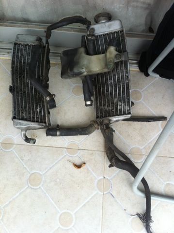

well you a bit late cos I took mine out last week... and I dint take pics
but I didnt really take all apart.. so this is the state of it now
I'm gonna block off the carb de-icer pipes... any one got any tips on which particular method to use? ( ie how to do it :p )

Your radiators look bent out of shape fishy!! Good idea to degrease & jet wash out all the crud inside and ouside them.
I just connected the pre-warmer outlets with a spare bit of tubing, so it goes out of one and into the other- genius!! Just block off the carb nipples.
Be careful not to get an air lock in your rads when you refil. Lean the bike to the right hand side. I actually got a large syringe and filled the left hand radiator to the brim using the drain tube on the top. Once it was full, put all the caps on and drain fluid out of the coolant drain plug (on the pump) down to the correct coolant level mark.

Thanks for the Pic fishtail. It helps a little! I have an issue with the expansion tank and the routing of my powervalve cables, a bit more fiddling and jiggery pockery will be required.
Any more pictures anyone has would be greatly appreciated.

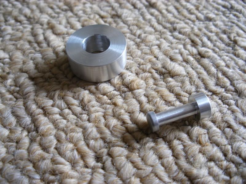

I designed a bung (shown on right hand side of below image):
http://i26.photobucket.com/albums/c122/ ... CF2157.jpg

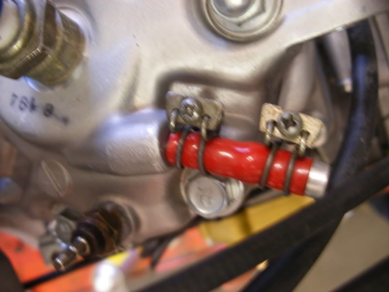

and bunged off the head as follows:
http://i26.photobucket.com/albums/c122/ ... CF2247.jpg
I was going to use an allen head bolt as knackered suggested, but luckily could get machining done fairly easily so thought the special bung would be best.
I had CR rads so only had to blank off the head. I did however have to take the thermostat bypass tube and tap it into the flow back into the coolant pump.

No, I would use a shortish bolt, use a thread diameter which is the same or slightly larger than the bore of the short hose section you use. Push the bolt all the way through until the head sits flush as like a collar. Then clamp both pieces. In honest, I had a slight leak, but this was as the clamp wasn't clamping down equally due to a different O/D hose, but i put a dab of silicone down the short tube to bung it properly and no problems.

You can see the blanking method here also:
http://i26.photobucket.com/albums/c122/ ... CF2246.jpg
