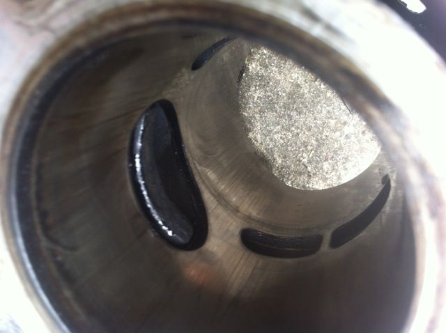

looking down the cylinder barrel

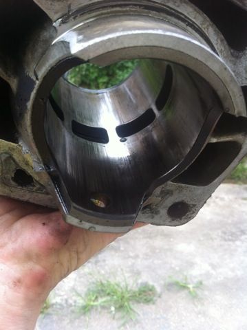

stripped it off today

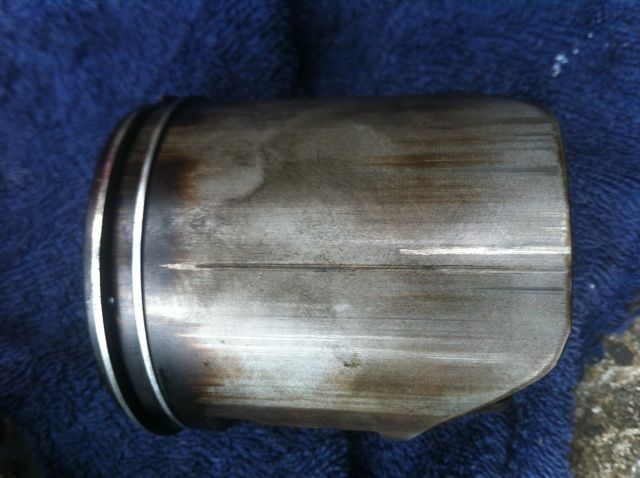

few scratches... seems like a horizontal line at the bottom of piston stroke..
piston is scratched a bit.. and scorched,, will it live? or get a replacement?

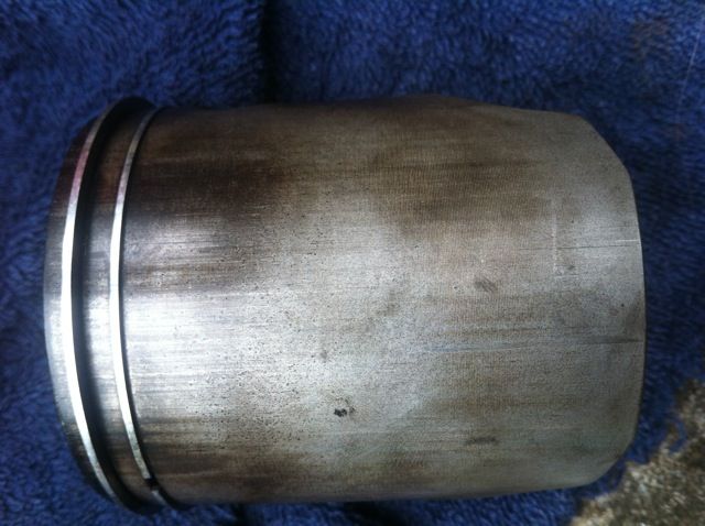

Re: looking down the cylinder barrel
The hoizontal lines at the bottom and top of the stroke are where the piston rings tip and very slightly dig an edge into the bore.
I really would get a rebore which means you have to changge the piston. Don't forget to replace the small end bearing as well.
+1 ^^^^^^^^
looks to be 66mm.. ( or possibly 65.5 mm)
The AR is nicksil the rest are iron lined which you can rebore up to 68.0mm (or 68.25 if you can get a special piston from Wiseco).
You need to find someone who will do the rebore for you and get it accurately measured. Then buy a suitable piston and get it rebored. The reborer will have to work on the PV as well.
Its interesting that LT have the bore offset rebored on the AR so that the powervalve is not touched.
Yes, I wasn't too pleased about this, however as it's only going 0.1mm oversize, it will only be offset 0.05mm. You will probably get more wear on one side than another in the Nicasil lining??
Nicasil is probably one of the hardest compounds you will come across, it will blunt files
Carefully take a file to the bottom edge of the barrel, there is sometimes a visible flashing around the ports as well.
From the photos it certainly doesn't look to be a Nicasil barrel.
I just put a long post in to tell you that your barrel is iron lined. For some reason it's not been accepted
TAKE IT FROM ME YOUR BARREL IS IRON LINED AND HAS ROOM FOR PLENTY OF REBORES
You can see the two metals particularly from the bottom view of the barrel.
Stick a bloody magnet on it ...................................
Get the current bore measured accurately. Then work out how much you need to rebore to get back to smooth iron. Then buy a piston of that size and get the rebore done to the size of the piston. Pistons vary very slightly in their sizes so this is the most accurate way to do it.
Those scratches are horrible fishy and your piston rings were leaking too- get the damned thing rebored!! Its a bloody mk3- I can see the steel liner in the picture!!
If possible go for a lighter & stronger PROX or TRX piston (this will need different bearings & gudgeon pin and clips), but a much better piston than the CRMs. Don't go mad with the reboring + 2 (0.5mm) overbore should be fine. Get a piston first & take the new & old piston with the bore when getting it done & leave the powervalve in place. Don't forget to get them (or you) to shamfer the ports on the inside of the bore (read your other post). Careful- the powervale will need ground down too!! Do check this by putting the piston in and checking that the powervalve moves its whole distance with the piston fully in place once the rebore is done- the prats I used said they did, but they hadn't!!
