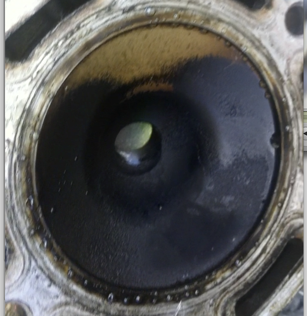

was prompted into action on this today - when todays ride was cancelled due to the bike fouling a brand new plug in 3 mins... it then fouled another plug pretty soon.,
refused to start... had a look thru - and saw mention of worn rings... ( also a few people here suggested I take a look down my cylinder anyways! _
( this week had a major electrical failure - resulting in me juddering 30 miles with no powervalve! )

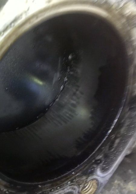

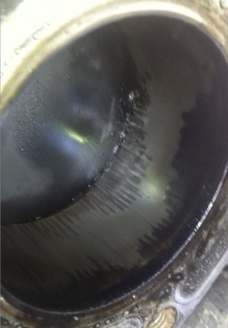

here's down my barrel
so how is it? - I uploaded some vids so you can see a few cycles - if the stills arent clear enough ( http://youtu.be/RkN0rjjJXzw )

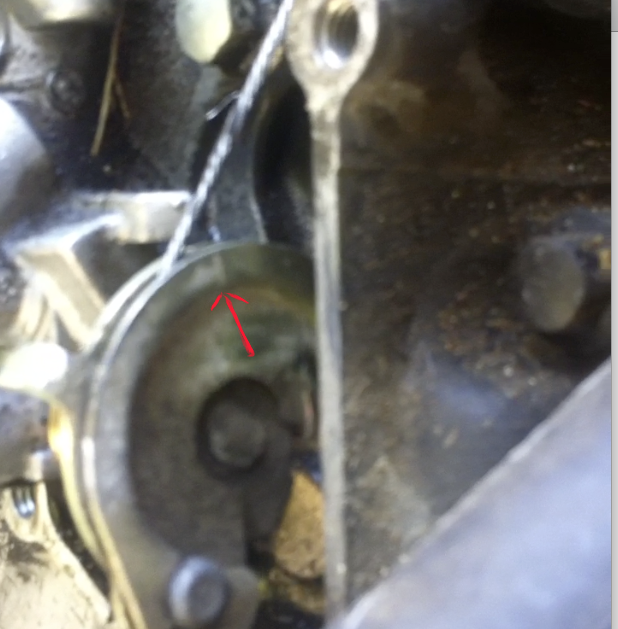

wondering if I have lined up the right mark on the oil pump? ( seems to be 2 marks? ) one is a bit "A" like - the 2nd further round is more of an "I" and goes across....
it was more or less om the "I" when I got the bike - ( assume was right )

The 'I' is a line and it should line up with the pointer at full throttle. Yours seems to do that.
The black on the cylinder head is not an issue but it would be a good idea to wipe/rub the carbon deposits off. Looks like you have bee running a bit rich which is much better than running lean.
You barrel badly needs a rebore but that's not why your fouling plugs, unless you haven't got enough compression for the engine to run anyway.
Other option is intermittent electric fault.
You really do need to strip the engine down and recondition it.

those oil streaks on the barrel are the indicator the rings arent a tight fit right?

I didn't think your cylinder looked too bad- I can't see any scores or burn marks on it, but its not easy to see if its oil or scratches in there... Yes its running very oily and there is a some carbon to clean off- this is easy to do using a Dremmel and polishing stone- also may want to take out the power valve itself and polish that up, as less rough for oil and carbon to stick to. Oil pump setting looks ok- if the 'I' and the pointer line up when on full throttle. I think you are running far too rich still and too much oil- this affects the mixture. How is the compression? If you can just about turn the cylinder over with your hand, then its too low. Now I have mine redone with the lovely TRX piston, I can literally stand up on the kick-starter before it turns over (mind you, I'm only tiny and I have increased the compression a little). If so, you need a rebore and new piston & rings. This can definately improve its running.

its definitely oil...
I can wipe it away... could it be the rings are shot?
rebore here costs HK$600 = about 50 quid
+ piston + rings and small end bearing...

I stick to my guns re rebore & piston.
If the rings are worn that much then the bore must be worn even without there being significant marks.
