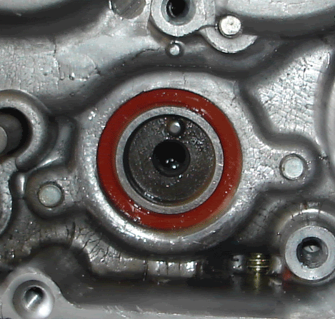

I just attched the gear lever so I could attatch the gears. it seems a bit tempramental.
I thought I had aligned the gear selector drum correctly when I installed it.
I can click through the whole rage of gears (sometimes) but it won't go into 6th gear.. The drum selector
doesent make it to the next tooth (if that makes sense) it rests in the middle. And sometimes
it will do this on the other gears too. This is a hard one to explain.
What do you reckon...Gearbox problem or gear selector mech problem?

Re: Gear selector mech
in hindsight I've just noticed that I don't have neutral - in any gear selector posistion
the sprocket spins on all of them..
I'm hoping to god I've installed the gear mech wrong
That is by far the most likely thing
Yep - I reckon I dident install the drum in the neutral position.
I am still struggling to get the bike in neutral.
When the 2 dots are aligned -- the dot on the detent rotor and case marking - should the bike be automatically
in neutral? because it isent, does it need to spin another 360 degrees or more again to reach the same point again?
I am a moron - even though the sprocket was spinning I dident realise that if I put any light pressure
on it would stop - so I am in neutral after all
FUUUUUUUUUUUUUUUCCCCKKK!
The thread has just snapped off inside the engine casing
sorry man - that stinks, can you helicoil it?
I am one lucky son of a bitch -- I just got it out
I was wedged deep inside the shaft so I put the other broken peice in and manged to screw it out so it was flush with the casing and used a very small screw driver and hammer to slowly turn it out.. thank feck for that - that could have been a complete disaster.. I would have had to drill it out re-thread and split the cases again to get all the poo out.
