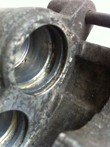

well finally went in.,,
here are the pistons..
are they servicable? - I tried wiping them with a soft cloth and sprayed em with cleaner ( sever times ) the surfaces dont look particularly smooth
the calipers were filthy on the inside - I spent 30 mins with soft cloth and soft tooth brush.. - think some of the grroves where the seals go have a bit of corrosion on them,,
just cant get them cleaner ?
wondering if they will qualify as being "better than before" if I just say sod it and put back together....

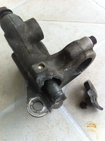

oh yeah and then there's the master cyclinder.... the boot seemed to be jammed in - eventually it came out - but not in one piece
and the botton I needed to grab with pliers - it came out and there's a metal ring inside the rubber that had corroded to crap and back,..
but this happened on the way...,, :shock:
oh well looks like I will be getting a new master cyclinder after all --

for seal grooves.....i leave a drip of fluid in the groove gently scrape the offending cack with a dental pick.then wipe out and give them a quick whizz with a soft nylon brush in the dremel.........works a treat every time........ :P

well I got the electric toothbrush on it cos I dont have a dremmel... ( maybe I can get a head for my electric screwdriver for next time! )
seems better - and the brake fluid did better than the "brake cleaner spray" I had brought.
got mastercyclinder ( 2nd hand) from an XR400 - the guy in the shop put in new seals for it... well he offered and I thought why not!
