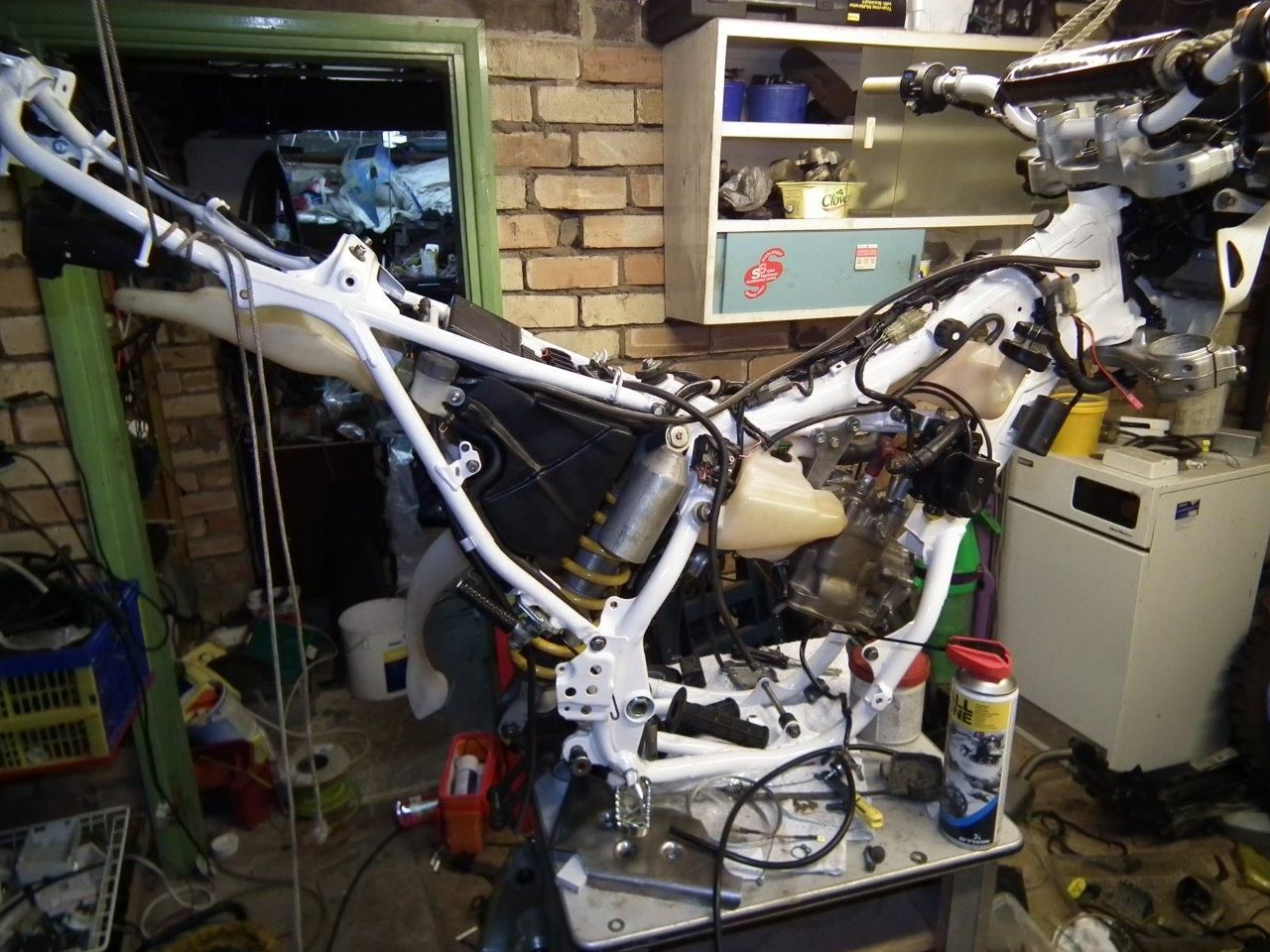

Things are proceeding nicely. The engine is now rebuilt and installed. Best of all I get a spark when its spun over which is always a big relief with an AR as there is so much that can go wrong. My engine turned out to be in great condition apart from the scored bore and piston. I didn't strip the bottom end as all appeared good after a good flush with petrol and when I did a leak down test the seals were holding both pressure and vacuum fine. There was a tiny bit of play in the balancer shaft due to some scoring on the shaft. Fortunately the one in the spare engine was perfect so that was the only other thing I had to swap. Thus, gaskets, new rings, some nice shiny stainless steel fasteners and paint was all that was needed These engines are clearly tough as both engines looked they had been used well!
Still lots to do but things are on track for late Spring.
I failed to put photos up when I tried a few weeks back. Don't know if I am doing something different or some site settings have changed.
Keith

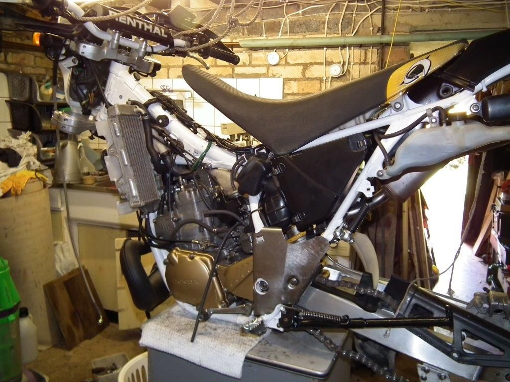

I had another go and the photos worked this time though I did have to resize first. I rebuilt the (road) wheels with new stainless spokes. However, I need to do some more Zinc plating and then I can put wheels back. I think I will use my existing fork legs for now even though the anodising on one is quite bad. I rebuilt them a couple of years back so they are functionally fine. I'll do something with them next Winter.
Keith
Keith

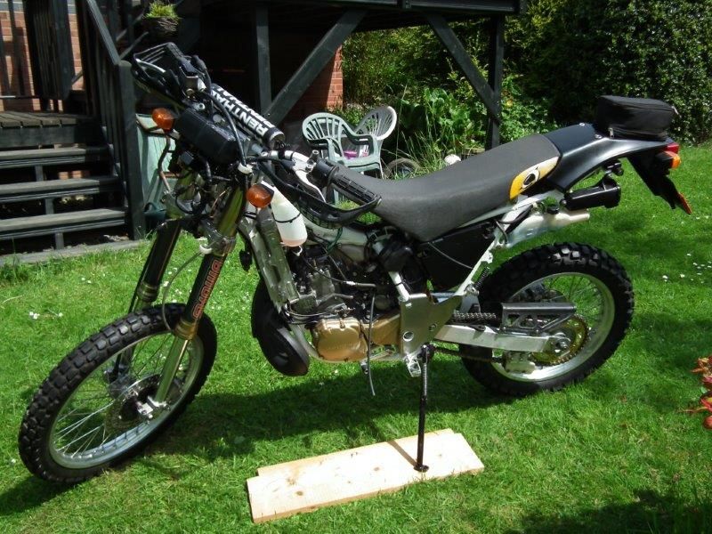

Well after a flurry of activity its pretty much done apart from dealing with the battered plastics and a quick tank respray. I rigged up a temporary fuel tank and it fired up 3rd kick and runs lovely. Best of all it now restarts easily which it certainly never used to do so I am pleased. There is plenty of time to go before I need it for the classic TT so I can relax a little now
Happy days!
Keith

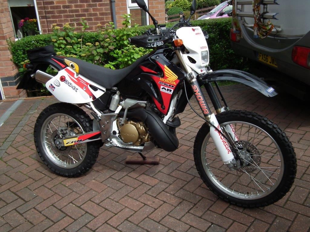

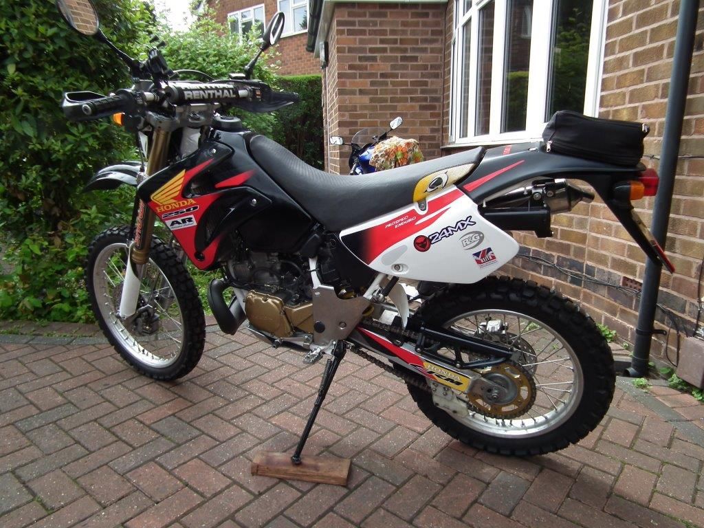

Well after a final flurry of activity the CRM250AR is finally done. Just need to get it MOT'd to be legal. A couple of trips around the block revealed a 2t oil leak (level warning switch) and an antifreeze leak - both now sorted. Even that short run on a freshly rebuilt engine shows how much better it is now running. It starts really easily and started to pop the front wheel up in third without trying so I am looking forward to putting some miles on it before the classic TT
Keith
Keith
