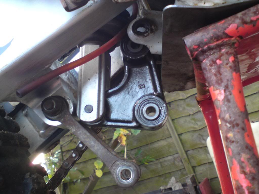

The shock there is a CR125 shock and is about 2 inches longer than a standard crm shock.
The easiest way to drop the back end it get some new dog bones (linkage plates) made. They should be about 110mm between centres (Mike is this correct?) this will drop the back down quite a bit.
make sure once you do, you set the suspension up to your riding as you might need to stiffen the preload.

I would buy a second hand shock for your AR and work from that point rather than messing around with a shock that was not made to fit the bike and will be wrong for a whole heap of reasons - not just that it is too long. Look in the 'FAQ-check here first' to see what can and can't be done.
Rising the forks in the yokes/dropping the yokes on the forks is a good idea.

I've had another look at your photos. The shock you have pictured in the linkage shot is from a CR I think. The other shock on your photobucket site (with the yellow spring and the red dots) is from a CRM AR/Mk3
They are definately different
Use the AR shock with some extended 'dog bones'.
You should post like - http://i181.photobucket.com/albums/x6/h ... forks1.jpg Or become a supporter to be able to post photo into text.

Thanks Mike for the info, I only have little feet (kids boots so no VAT for me) so probably less of a problem.
Those pictures are not mine I just borrowed them to illustrate what I was talking about KnackeredMK1 but thanks for the advice.
It seems like the AR has the standard rear and on closer inspection it also looks like someone took of the CR forks that were fitted and put the standard ones back on at some point.
We have pushed the forks up through the yokes going by what it says in the CR manual (front end looks similar) but they say to only push them up a max of 10mm showing above the top yoke? There is a lip on the forks but not till about another 10mm down but we will see if what we have done is enough before lowering it any more, at least the bike looks more level now.
It is taking an age to do the sag as we need to add alot of turns. We have got it to the right setup for OH but it still needs to go another 50mm to be right for me but I think we'll maybe split the difference, I did get OH to push back end down to the right height with me sat on it and I can get the balls of both feet firmly on the ground at the same time which is luxury. Looks like I might get away without needing the longer linkages if the sag adjustment doesn't make it to soft for OH.
